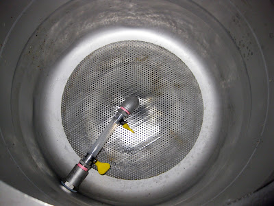

I'm thinking about buying a stainless steel pot to use as my mash tun. I've currently got these things in mind to make it work. (yeh its a little more expensive than an esky mash but this is cleaner and will last longer)
eBay:
- 71L stainless steel pot x2 (one for kettle, one for mash)
Beer belly:
- 1/2" ballvalve (reduced bore)
- 1/2" BSB hosetail
- 50mm S/S bulkhead
- 30cm domed false bottom
My question is how does the wort leave the mash when using one of those domed false bottoms? It's hard to explain but the way the domed false bottom is setup, ie with the elbow fitting coming out the TOP of the dome, do you need a pump for a setup like this? (I'm not looking at using pumps just yet)
I just don't understand how when compared to an esky setup the wort will obviously naturally drain through the outlet by gravity. Could somebody explain this? I'm sure there is something I'm missing....From the way I see it it looks like there would always be some wort left at the very bottom of the mash?
EDIT: Wait, does this work via siphoning, sucking all the wort out through the tube??
Here is a picture of the false bottom for reference:
http://www.beerbelly.com.au/images/f...ttom12inch.gif
Cheers!!

Here is a picture of the set-up in my MT:
Make sure its easily removed for cleaning.

I see! Thanks mate, I just wanted to know what was going on from the underside. I get it now
