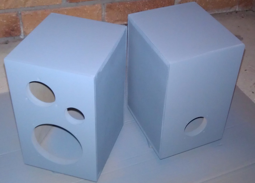

First coat of primer is drying now. The end grains soak it up pretty good, post a pic later when they are dry. Pretty trendy matte grey at the moment!

Finally gave the first coat a light sand. These things are very smooth. Pretty impressed.
Second coat of primer is drying now, then a very light 1200 grit sand and we're in business. Will laminate the back first, get my technique down pat. Front and top will be the most noticeable followed by the sides. Unlikely to do the bottom, i think i'll run out of material.
Should grab some feet of some sort for them too, hmm.

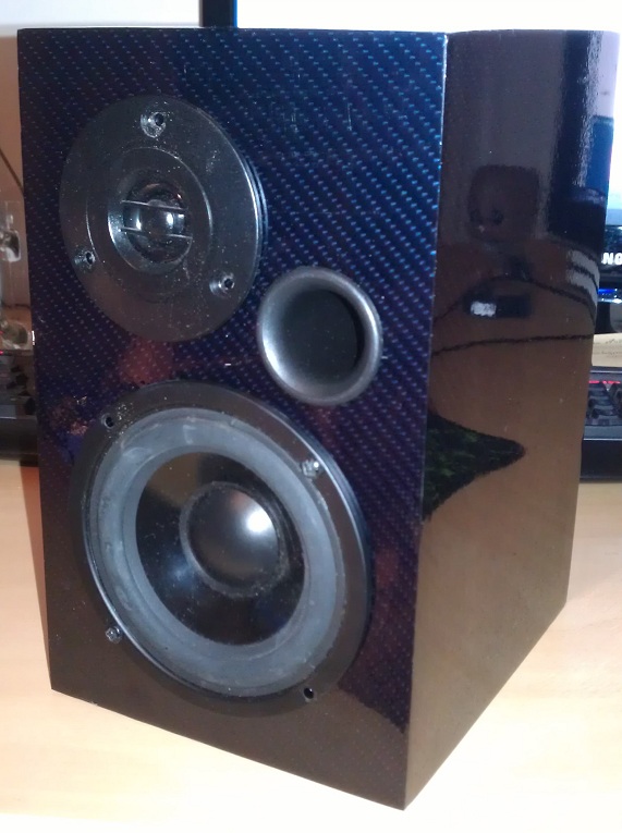

I have 3 sides done on one at the moment. Fiddly part is trimming the edges where two bits of laminate meet. Fine line between perfect trim and slighly trimming the existing laminate. So far pretty good, might touch up any small bits with a black pen.
Starting to look cool though! .....as cool as carbon fibre laminate can look that is...

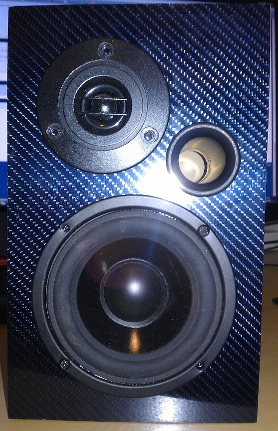

Just chucked the drivers in quickly to show what itll look like.

Old 15th June 2012, 10:21 PM   #27
Forgiven
Member
Forgiven's Avatar
Join Date: Jan 2004
Location: Brizzie
Posts: 882
Default
Quote:
Wow very nice.. Good Job there
