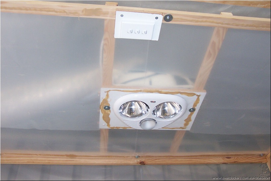

Build a spraybooth to make sure you don't get dirt/dust on your job and overspray on everthing else.
This booth cost about $50 in wood, $15 in screws/hinges and $30 in plastic.
If you're really serious, add in the heatlamps/extractor fan. Breath easy, dry fast. Add another $100 for this and $27 for the silver slinky.
BlueSmurf.

Blue smurf and Defyant, you two have been very lucky so far with your booths... your both using a extraction fan that is a non sealed motor, you are sucking highly explosive fumes through a electrical motor that has bare sparking contacts/bushes, Id advise buying a Xlotto ticket because you are very lucky to have not end up in a burns unit so far.
Do not use a non-sealed motor fan when spray painting... think about it, If you happen to breathe in some fume and the fan ignites an explosion your lungs will be singed, possibly causing your death, is your computer worth that much.
The same goes for all electrical gear in a spray booth, you can actually buy proper sealed switches/conduit/lights/fans, they cost heaps , and Im not even going to start telling you about EPA reg's...

According to the MSDS I need a vapour concentration 35g/m3 for the hardener or 35g/m3 for the paint proper to reach the listed Explosion point.
While I have no doubt that the materials I'm using are flammable, there are a couple of mitigating factors.
- I'm using an airbrush.
- It doesn't even hold 35g of paint
- The booth is 3.8 m3
- The booth is not sealed
So even if I was able to instantly convert the contents of the airbrush to vapour, I'd be lucky to make 9.2g/m3 concentration (assuming a sealed booth).
I'm far more worried about the decrease in fertility and other nasty effects rather than the risk of explosion in these circumstances. If I was using a normal air gun, it'd be a different story.
