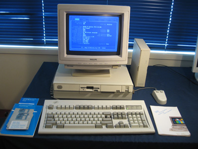

Nah it's got to be an AT case for DOS games
While the Aptiva case is very Retro, it's not authentic for the time period of games. It might fool kids from today though...
Now if you can find an old IBM PS/2 desktop case and put a mini ATX system in there.
Now THAT would be cool!

http://www.stevenread.com/art/img/go...reen_burn2.jpg

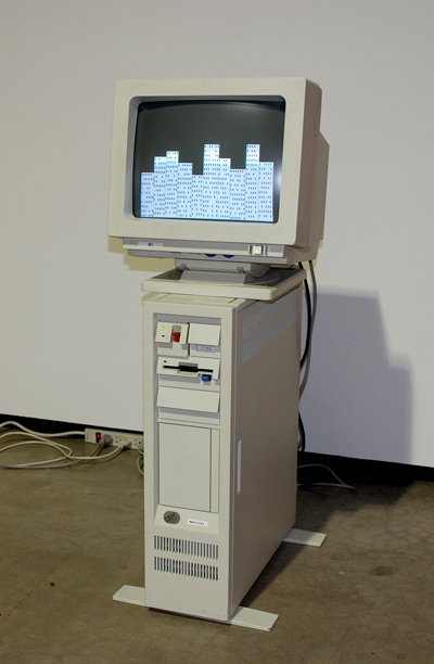

But these are the cutest:
http://www.classic-computers.org.nz/...30-2nd-pic.jpg
Now THAT'S what I call retro...
The Aptiva is nice, but it's already very modern in relative terms... Round shapes, ATX, Soft power...
It has to have a hard power switch. One that's so hard, that when you flick it everything shakes a little :P

You couldn't really build something in either of those cases
The two linked ones, not your ones.
Most AT cases are similar in shape to the aptiva, it only has one round bit on the outside which is a handle thing on the top. The rest is pretty much square, beige box, with a nice door covering the drive bays like some other older AT cases. The interior form factor of mATX does not really dictate how old it looks on the outside and the OP would still need to convert the mobo tray to ATX anyway
