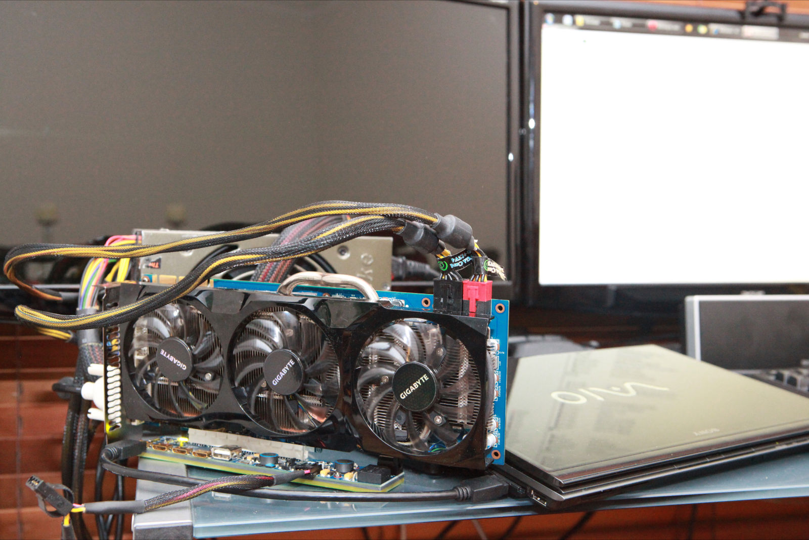

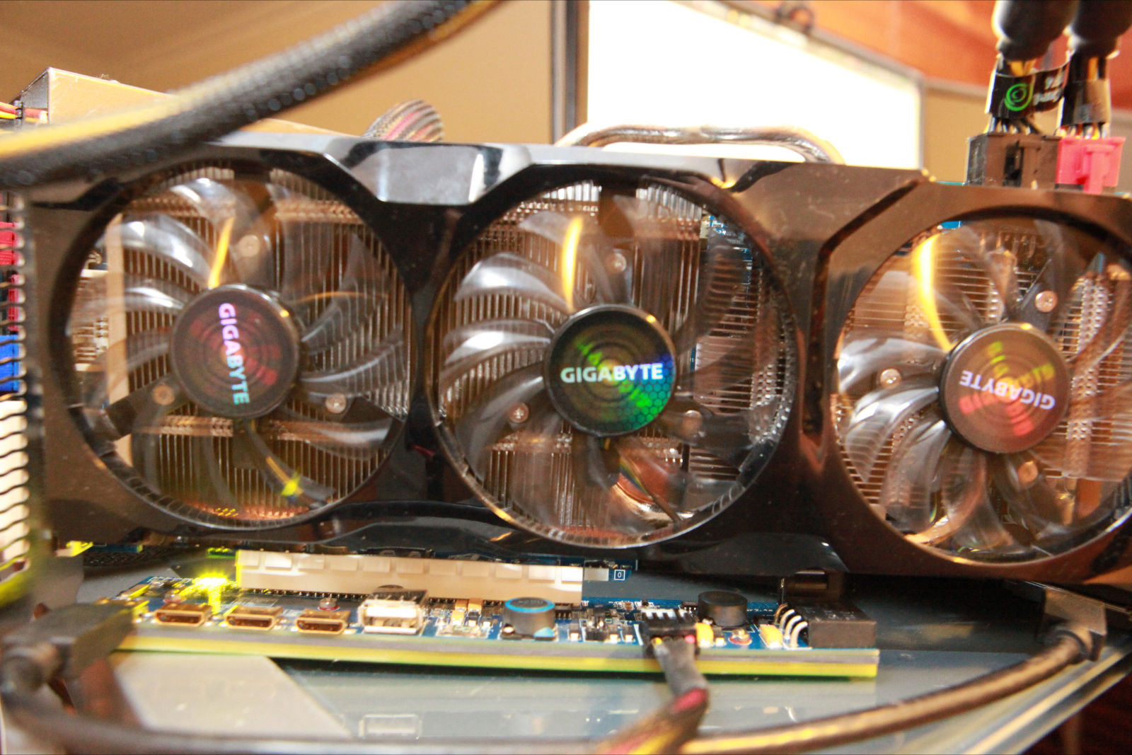

    Shaken not stirred...
    [​IMG]
    [​IMG]
    And you get...
    [​IMG]
    [​IMG]

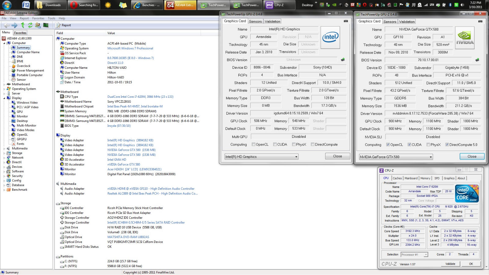

    It only performs at about 60% over @ PCIE x1.opt (with Nvidia Optimus drivers)
    This is about PCIe x2 performance but it still shits all over the GT330M.
    $85US
    Everything you need to know is here...
    http://forum.notebookreview.com/gaming-software-graphics-cards/418851-diy-egpu-experiences.html
    WARNING its not a simple plug n play affair. You have to do a fair bit of driver hacking and bios hacking to get it to work for some systems, particularly for the Vaio Z because of it's gay Hybrid graphics and Sony's slack video driver support!

    For those wondering what real world performance is like.
    In Crysis 2 DX11 Ultra pak @ 1920x1080 I get min 24fps avg 35fps outdoors and 50FPS indoors. Compared with the GT330M struggling to do 20FPS on lowest settings @ 1600x900!
    My favourite flight sim gets 50FPS compared to 3FPS with the GT330M.
    18K Vantage compared to a desktop GTX580 @ 24k. :thumbup:

    And just to put that into perspective, my built in so called dedicated GT330M does Vantage P1825 and 5fps vs 18900 and 55fps for the external GTX580.. Thats a 1000% (10x) increase in performance.
